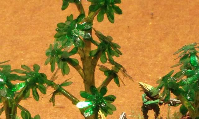

Brilliant stuff yet again mate!...I just have one question for you. How do you find your miniatures in all that foliage? :eek:
Fortunately I have been blessed with God-like powers, and have the ability to look down on them from up high. This usually solves the problem for me but not always. I did have one case where I found a unit hiding in a patch of woods while cleaning up after the game. I had cleverly placed them there in the hopes that my opponent wouldn’t notice them there, and then promptly forgot all about them myself.

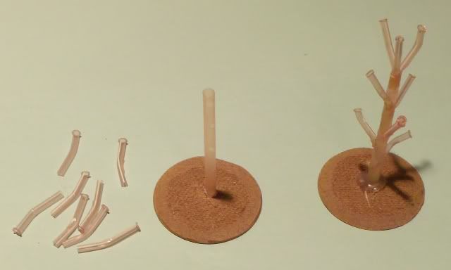

Gelatinous Bamboo!
This project took a lot longer to do than I originally thought it would. Not because it was hard to do (because these were very easy to make), but because life kept getting in the way. Nothing big you understand, just a long series of small distractions. Unfortunately I am easily distracted by shiny objects, and frequently get sucked into other interesting projects.
I started with some coffee stirrers (a few regular straws for the big ones), and a new paper punch that I got on sale for $3.
I cut each straw into about eight pieces (just make sure that they are about twice as long as the desired length of each segment when finished). One end is flared out using a candle to melt the plastic. The other end is then tapered in by pressing and rolling between your fingers.
If you cut a slit about half way down the straw this tapering process is much easier. Then simply stack one inside of another till you reach the desired height of plant. I used a little hot glue on each joint, and inserted a leaf stem into the joint. The straws are very flimsy on their own so I used a lot of glue to support them internally. I painted the whole thing in one solid color since the leaf, and stem were made from differently tinted plastic, and provide contrast on there own.

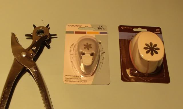

I used a simple flower shaped paper punch to make these. I started with a small steal wire since these were very slim and needed to be stiff enough to stand on their own. I had expected the wires to be visible through the glass beads, but it actually worked out quite well. The glass beads and flower petals were alternately stacked onto the wire, and glued in place with superglue. The plastic I used for the petals is a little stiffer than I would like, so unfortunately they don’t droop properly.

I used two sizes of flower punches and a hole punch to make these. Unfortunately I broke the larger punch when I was about half way through with this project. Not terribly surprising since they are designed to cut paper, and I am using them to cut much harder plastic sheets. After a suitable mourning period in which I complained to my wife about how unfair it was that this tool broke, I then shifted gears and started a new plant with the remaining trunks.
I used the hole punch to make several holes in a straw, then glued it down to a base. Hot glue was then squirted into each hole and a coffee stirrer was inserted in to form a branch. The heat from the glue and the stirrer deformed the straw enough to give it a more natural shape.

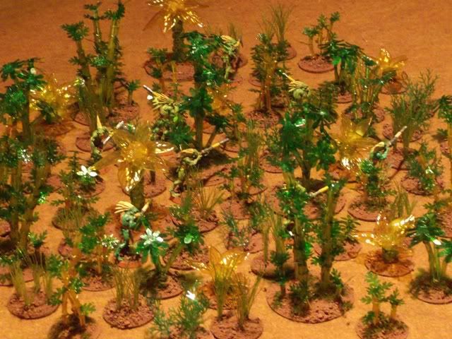

You have it easy Tael, you only have to store the pictures. I have to find a place to store the pictures and the actual models. Here are a few more pictures for you to fill that new external HD up with!
I think that these newer broad leaf type gelatinous plants have officially split off from the earlier foam bubble type. I am going to start storing them separately, since I am now playing them separately anyways. My gaming room is starting to overflow with all of the different terrain sets that I have now. Life would have been so much simpler if I had gotten addicted to a game that used a smaller scale than 28mm.

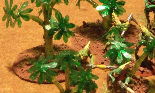

Field Craft exercise, how many Kroot can you spot in this picture?

Hmmm, spotting Kroot eh?
Spoiler: show
I gave it my best shot and got a different number than you did. I then got out a high angle picture to check who had the right answer and discovered to my amazement that we were both wrong. This is a lot harder than I had expected. I think that I will open another thread on this with a bigger picture so that you can have a fair chance at it.
