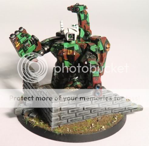

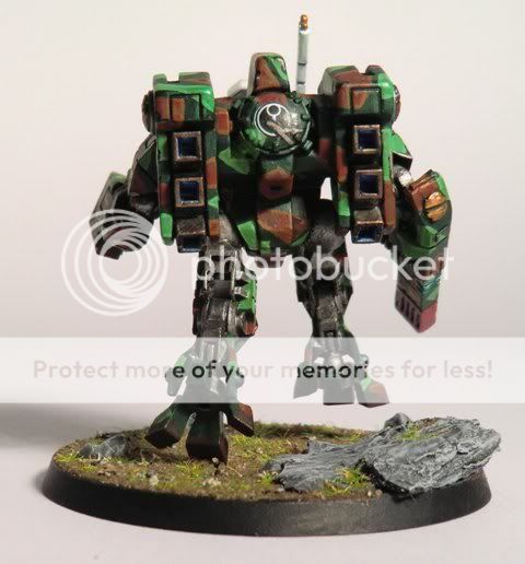

Other examples:
A large rock outcrop made from 2 pieces of bark glued on top of each other
Using parts of the Tamiya wall set (1:35 scale) http://www.tamiya.com/english/products/ ... 35028m.jpg
The wash colours can be varied between different shades; I have tried green and different shades of brown with good effect. 1 Litre of wash will do many hundreds of bases at a cost of around 5 Euros.

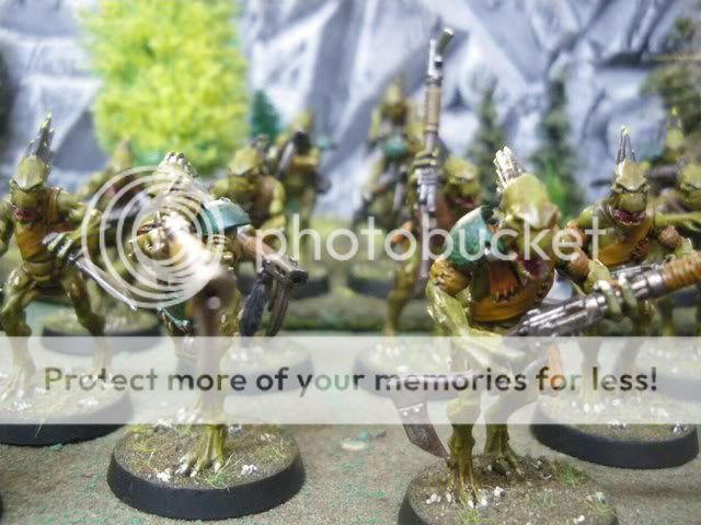

The static grass (autumn effect – a mixture of greens and brown) and gravel flock I use came in 20g bags and I am still using the same ones as when I started my Tau/Dark Angels and Imperial Guard and my sons Tyranids so it is going a long way.

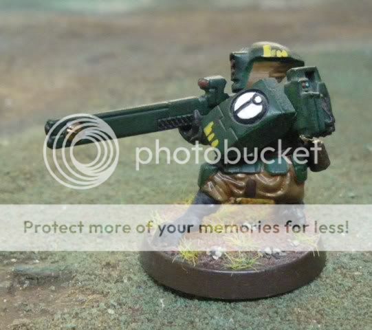

For the 25mm bases I tend not to use the bark and stones and this makes it even faster. The figure is normally glued to the base and I just paint the PVA glue around his feet.
Also good for the large oval bases
