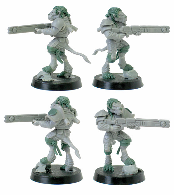

The Shea'Vesa
A strongly built, animorphic humanoid feline race. You can find their history here (NB to be finished), for those inclined to incorporate personalised rules and RPG background.
The Parts List
Select a Beastman Gor head
Imperial Guard Cadian chest + arms
Tau legs
Beastman Gor lower leg sections
Beastman Gor pony tail (serves as tail for shea'shi)
Pulse Rifle
Greenstuff
Two Imperial Lasguns, Cadian Range.
Firstly the head :
Select one of several head pieces from the current Beastmen plastic sprue. I've checked the latest 2010 edition and noted the ones I used before are still part of the set. You can see them highlighted here:
Remove the extraneous details (though for some, retain the pleated pony tail), then carve into the plastic to create a spilt in the upper lip. Overall you want to clean away any major details to leave what you see here, then carefully fill in the cranial area with Greenstuff. Adding some Greenstuff to the upper lip may be necessary to clean the incision made there also. Overall, craft the cranium to match the bulk of the Gor head, but since this will be covered with Greenstuffed hair, it is merely base. You are aiming to provide the shape underneath essentially.
The Legs
Following on from this, time to work on the legs. Here I remove the shin portion, below the knee plate, from the tau legs (any set will do, to vary postures). Drilling a hole in each part and inserting a co-joining metal pin to fasten the parts, affix the shins of the Gor plastics to the upper legs. Be careful to point them in the direction of the upper legs to avoid odd gaits. Using a small amount of Greenstuff, cover and smooth out the join, even remodel the pants about the upper shins if you wish. I usually add the pony tail "tail" at this point, bonded with plastic glue to create a seamless meld just under the lower back posterior plating.
When you have placed these on the base, use some greenstuff to model the padded paws and their toes. You can be as simple or as detailed as you wish here. The images provided are a guide to show how I went about it. Allowing the greenstuff to cure for 30mins (provides a hard edge) then pressing the detail into the Greenstuff working downward toward the toenails.
The Body
Right, those elements done, onward to the less fussy upper body. Here you add two Cadian lasgun muzzles to the back, about the small box shape there. These act as the heat vents for the furry chest underneath, part of their 'Lore'. The cadian arms remain untouched, the only interesting part is blending the pulse rifle into the lasgun stock which you can see how I achieved this in the photos. Additionally, I usually add the head piece to the torso at this point and work on their mane. In some cases I have long upper hair tied back, with cropped temples, or an overall head of hair tied back with some loose strands to emphasise the look.
Once all put together you should have a result similar to this, albeit with a pose and added parts of your choosing :
