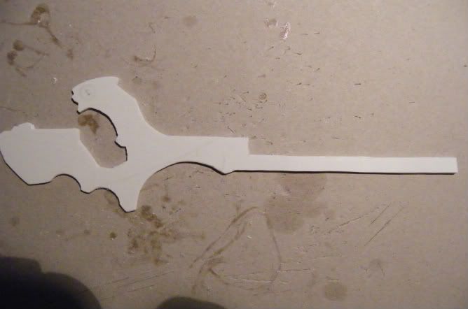

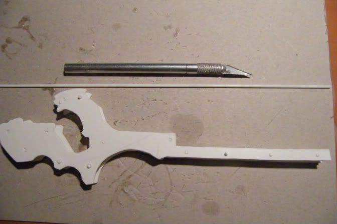

I remember starting with the Skeleton the same night I drew up the concept. It was early in the morning when I finally went to bed. :)
The following pictures are from the first steps of the project. I needed a soled base to work on so I came up with a plan to build the structural skeleton. I will be building the ship entirely out of plastic card. This is going to be a challenge for me because this is going to be the first time working with the stuff. And as I said before, I'll jump in the deep when I start something new. Exploring ways and new ways to get the pieces I need to assemble the hole thing is an adventure and I'm learning new skills every day. Also I'll be adding some Original Tau and Warhammer bits, as well as anything that I think is suitable to get the job done.There will be a description with each picture on what and how I did the particular piece. Some of my methods you will do differently, this way just worked for me best. All right, here we go: Skeleton.
I drew a rough outline on plastic card and cut it out with scissors and using a sharp hobby knife. Very tricky business and a lot of work.

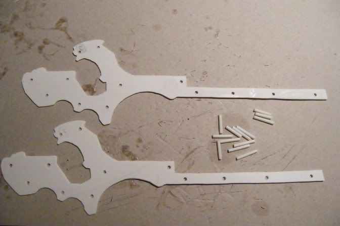

I needed 2 of these pieces. I placed the first piece all sanded and finished up on top of another piece of plastic card and glued them together.
This way I could sand down the second piece to match the first. The next step was to drill 2mm holes. I chose the holes location in a way they wouldn't get in the way of further construction. And if they would I could cut out 1 or 2 without damaging the structural integrity.
Next was getting the 2 separated to never to touch each other again. And voilà. 2 identical pieces with perfect aligned holes.Next I got myself 13 pieces of pipe of 1 cm long to put in the holes and hold the 2 together.
Finished product:

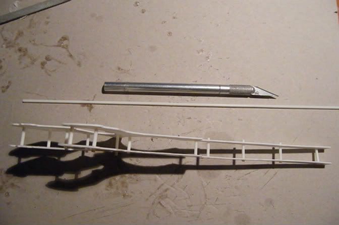

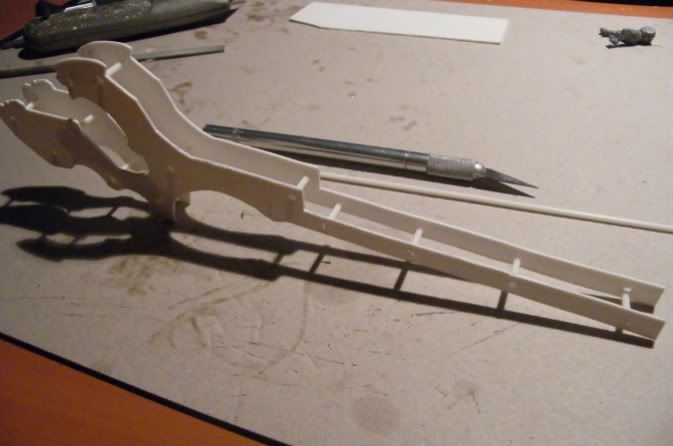

With this Skeleton I could get started. Its exactly 1,2cm wide. This way it would be easier to work with pre-cut existing plastics of all shapes and sizes. Next up: top and side panels.

But one question comes to me. looking at that 'skeleton': Is it stable? It surely will become stable when you add the other parts of the bikes, but I am wondering of the current stability at this point.

With all the support points I think that it should be stable enough, so I do not think that it needs to be filled it with GreenStuff. If it is not stable, the chassis should stabilize it.

Thanks Militant.Jester and Che, it amazed me as well that this method really worked. I was quite happy with it because it turned out to be a very good skeleton to work with. It gave me enough room to alter the build schedule as well. Good question, of course you want to have a strong and soled base to start your build on right? Well, after some good measuring (I wanted it to be exactly 1,2 cm wide at all points) and some good extra gluing in the inside (were the pipes meet the plastic) it end up to be quite strong and stable. Of course 2/3 of the "how to build this baby plan" was already in my head when I started on this skeleton. As you will see in the following pictures adding new parts made it more and more strong and stable. Jester, putting greenstuff inside it would of bin a good idea. But with the build good under way and for 2/4 finished its strong as a rock. (I have taken a picture just now, writhing you this reply to show you what I have done to improve the structural integrity. :))

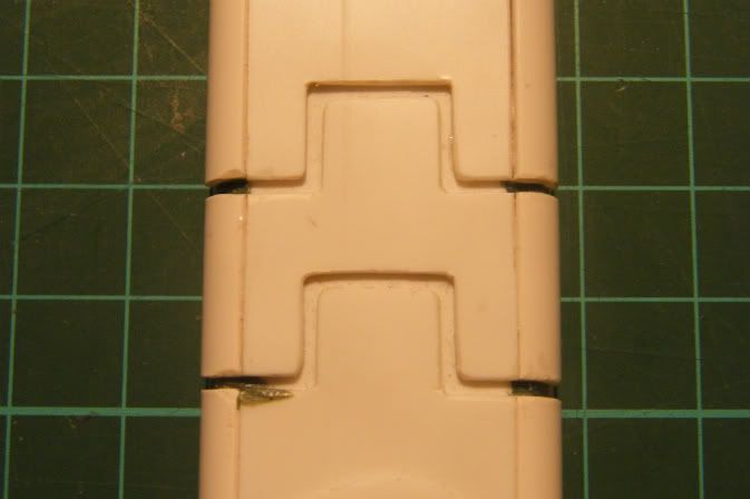

Al right. Side panels time. :) I wanted them to be not just on a 90 degree angle. No, I wanted a more dynamic flow and curve. So this is what I did:
I took measurements from the left top, all the way to the tip. Since I'm a perfectionist I want to do everything as slick and smooth as possible. Especially with the aesthetic of the Tau I think it's essential to be as accurate as you can. I Took the measurements on to the plasticcard and cut them out with scissors. I didn't want to use the "glue-on-duplicate" technique because I didn't want to have to sand to much. Instead I just did the process twice.
I drew on lines were the 3 ridges needed to come and cut them trough with scissors. Sanded them down with a little curve and placed a piece of plasticcard behind them, leaving a rim of 1mm between one another.
Then cut a space were the side panel would overlap the base of the wing.
(and added the first little detail, quite nice touch aye? they broke off on me, while further working on the engine heat exhaust.. ill fix it later :P)
The hole for the engine heat exhaust in the middle of the hall was 1 of the hardest parts of the project and it took me quite some time.
First determinant were the hole needed to be and very carefully, trying not to damage the rest of the surrounding plastic, cut it out with a sharp hobby knife. These panels are very important because they'll cover 1/3 of the hole ship. I think they turned out to be pretty nice.
The pieces of plasticcard that holds the 3 pieces together are less wider then upper parts of the panel. This little line of space, about 2mm wide, is the place were the panel is going to be glued to the rest of the model. You'll see what I mean later on.
As you may probably have noticed in the pictures, the side panels have a curve. (the hall will look like this: (""") instead of: [""] if you catch my drift?:P:) I bended the panels horizontally every 1/3 following the top line to the tip. This way the ship will feel more dynamic and streamlined.
little preview? :eek: ;)
Top:
So far so good, the side panels are looking like I wanted them to. On to the top. This piece was going to be easy. I really got in to it now and got myself some new supply's. My first cutting mat, and some new tools + material. I discovered a hobby store and I was like a little kid in a candy store. I took a piece of plasticcard (really getting tiered typing "piece" and "plasticcard" :crafty: ) haha.
Well, I took 2 pieces of plasticcard and cut it 2,2cm wide, this was essential because this way it would all fit perfectly on the skeleton.
The rims on the side panels were going to flow over the "top" creating that familiar Tau feeling. I'll show you.
Of course made sure that the pieces were well sanded, sharp and the measurements were correct.
Glue, glue and glue :)
Top view:
bottom view:
Rims detail:
As you can see I put pieces of curved plastic on the side to give it the "round flow" im looking for. I think on the "how" its officious right? measured the length from rim to rim and cut curved pieces accordingly.
