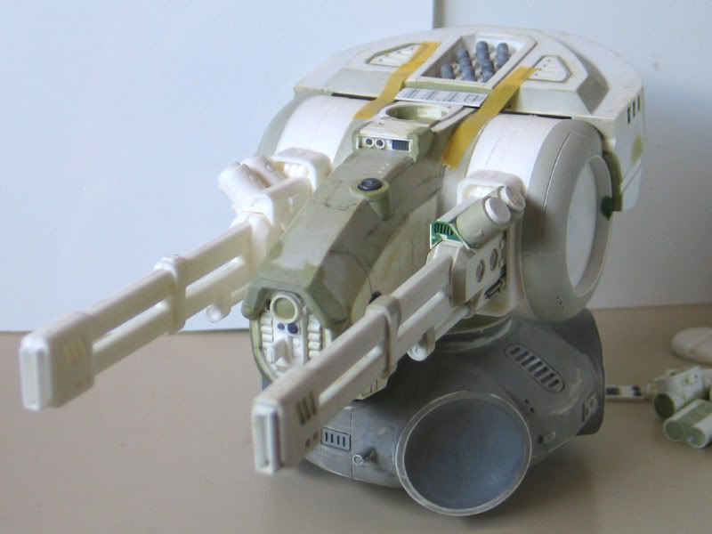

Pic of the modified sensor suite, as promised:
I'm so very happy with how it has turned out. As usual it's hard to make out the form with all of the different colours but you should be able to get the idea ;)
Not really much more to add to this post so I'll keep it short!

I do like that better, which is something I did not think possible. One thought did occur to me however, and that is that this thing will need massive pinning to keep the legs attached. Consider having 1/4" (~1/2 cm) metal or wooden shaft nearby.

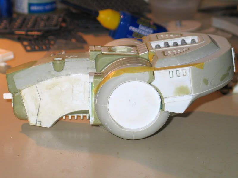

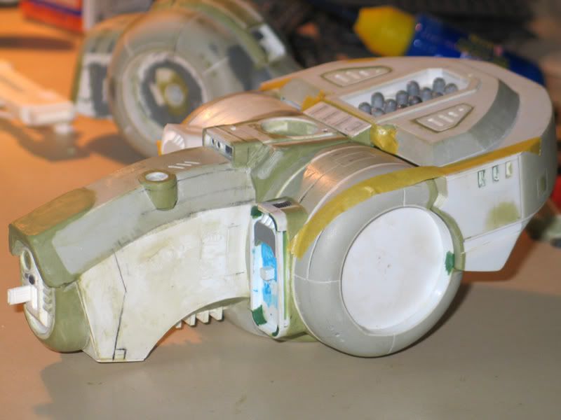

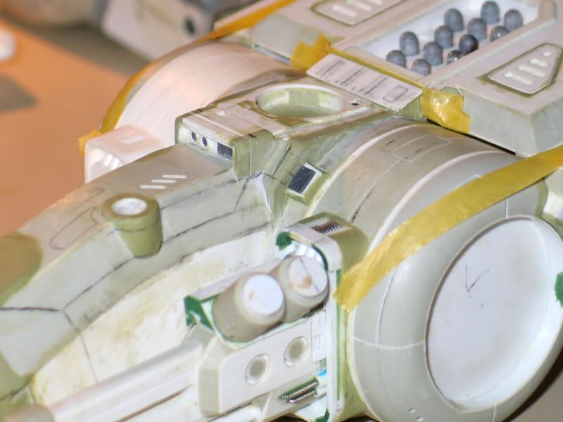

Just some quick shots showing the result of last night's puttying. I'm loving how the little discs on the side of the chassis turned out!

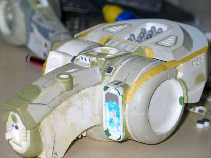

This morning I set it upon myself to sort out the cowling over the front sensor suite. As can be seen from older pics, I did have some pretty extensive puttying done but this morning decided that it just wasn't working. So off it all came!
The first step was to make the new cowling and because of the design of the recesses in the end I decided to do it in styrene. 3x1mm sheets were laminated together with the centre sheet inset slightly. Once that was set it was just a matter of chopping to length, getting the join angles right and then gluing little divisors in the recess. I'm very happy with the result, especially with how geometrically true it all is.
Over the course of the chassis construction the top edge that curves down to the cowling had actually ended up with a bit of a taper. To fix that, once the new cowling was in place I slapped on a heap of putty. Once set it will all be sanded smooth and perfect.
I had planned to take pics but by the time I had realised I had just mixed up putty and the clock was ticking!
You can also see the modified side disc arrangement - there is now only two of them and I think it works much better. I'm still contemplating the panel lines around the discs and have sketched in a small access panel just above them.

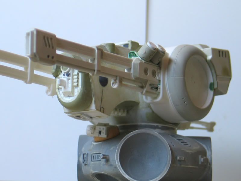

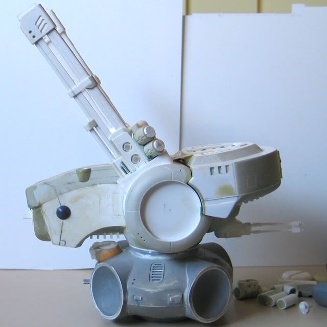

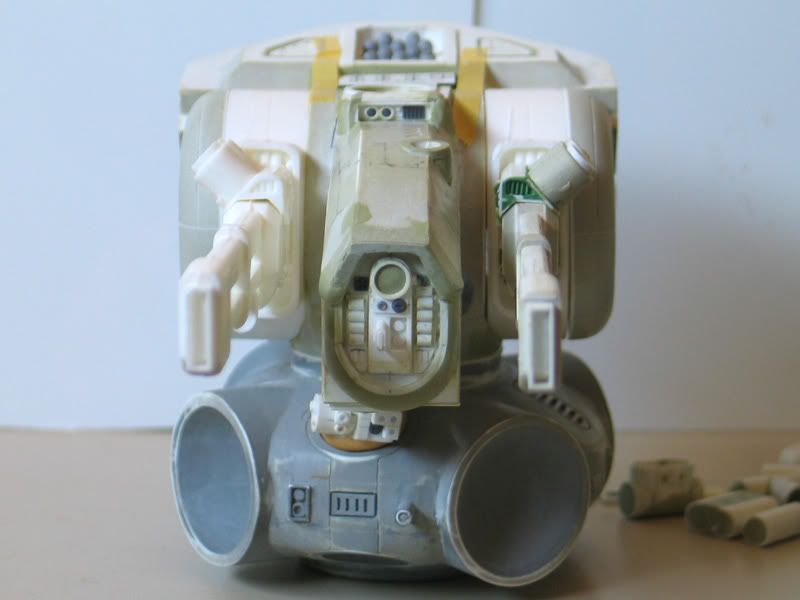

OK here's a big update - first stage of priming is done! Here's all of the parts I have made and the quantities used in the final kit (there is still a small amount of work to be done on the pelvis before I prime it fully):
(Warning 1/2 meg image)
It's amazing how many flaws the priming shows up! I'm going to have to go around with some putty and fix lots of little nicks and tool marks. Then a lot of spots are going to need sanding with around 1200 grit paper. I'm thinking I might get some Mr Surfacer 500 for the next priming attempt as it should theoretically fill the flaws better than the 1000 that I'm using.
