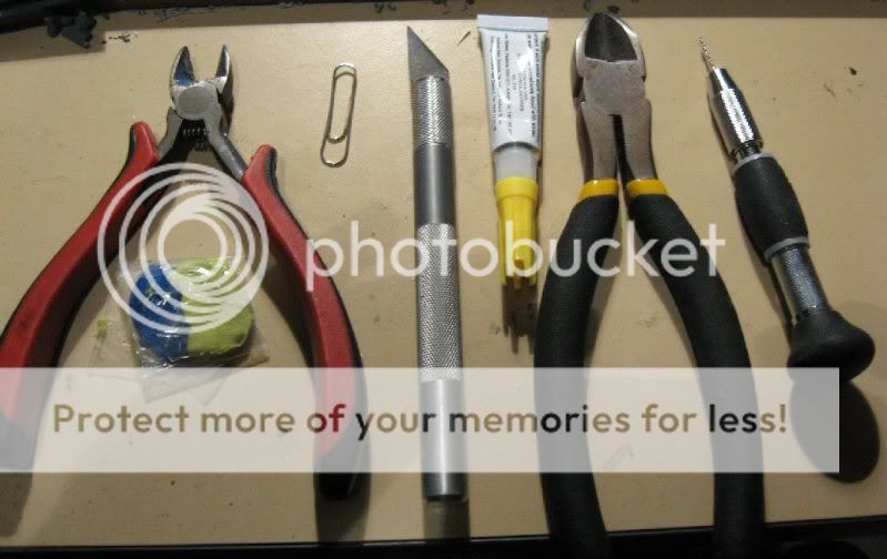

To build it you will need the following Tools
Knife
Pin Vice
Plastic cutters
Wire cutters
Glue
Paper clip (or wire for pinning)
Green stuff
You will also need... One Skyray Turret (both sprues). The bits from the sprues you need are

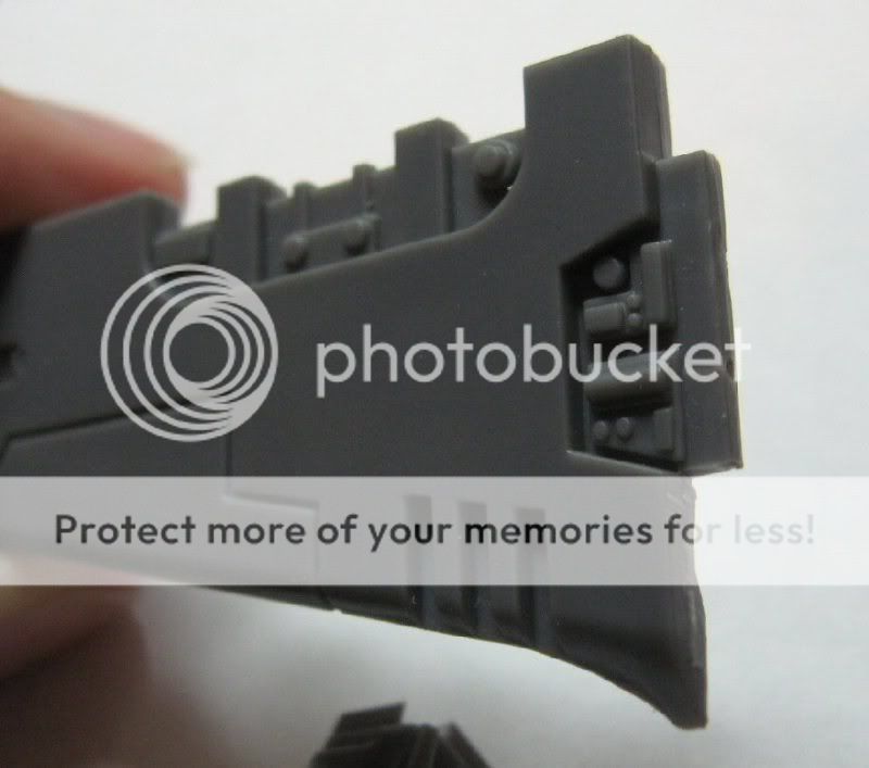

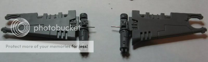

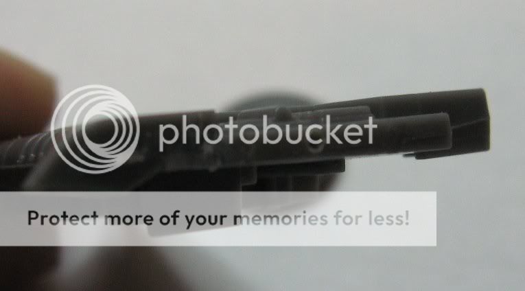

Once you have cleaned up the parts. Remove the lower hanging sections of the 2 wings so that they are both flat. You don’t have to remove the missile mounts unless you want to. If you chose to use the missile mounts for the Drones seeker missiles, hold off on removing them till you have chosen the position.

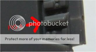

You will also have to remove part of the side bit of the Wing so that its even with the "detail" of the wing (see picture)

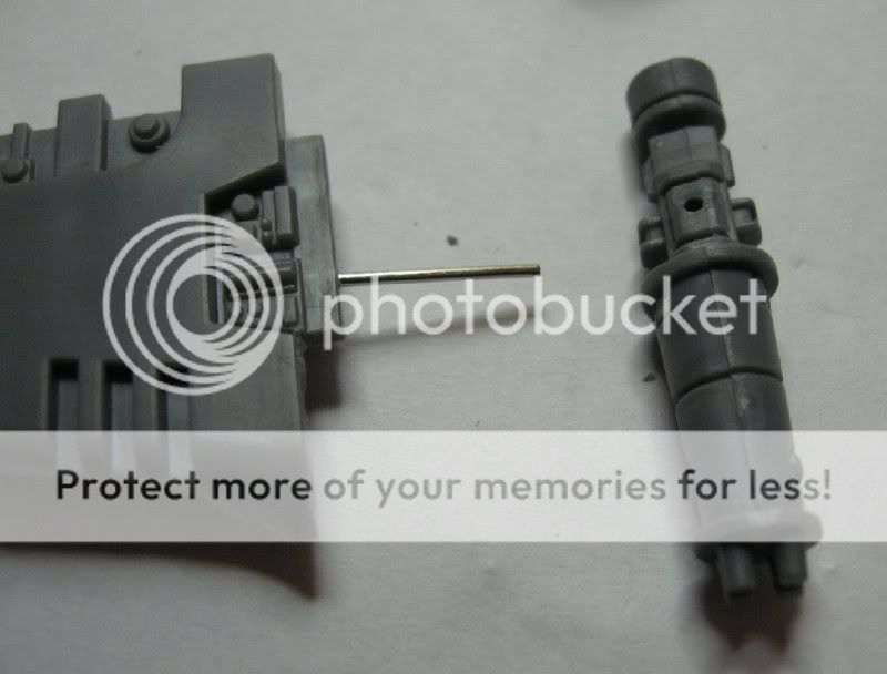

Once you have done that. Drill a small hole right into the wing as shown. This should be in line with the detail section I’ve marked as "Fig A" You should be able to see the small line the drill made in the plastic as I did it in the picture below.
Take the paper clip (or wire) and cut of length off it. This should be around 2 inches long. If it’s too long don’t worry for the moment. You need the length at this stage.

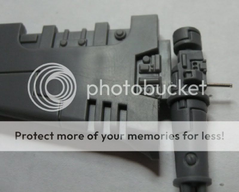

Glue the wire into the hole you just drilled. Take one of the Burst cannons and drill a hole right through the main body as shown here. You should also remove the small "Tab" that would normally connect the burst cannon to the side of the stealth suits arm as it will just get in the way)
You might want to drill half one side and half the other as this stops you from getting it off center.
Once you have your hole. Thread it into the wire attached to the wing and make sure the base of the burst cannon is flush against the small overhang that you had to trim earlier. If its not quite right just trim it until it is. Once you have the gun in place, make sure its parallel to the wing and glue it in place so it looks like this.
Do this for the other side as well following the same steps and you should end up with a pair of wings that look like this.

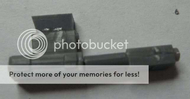

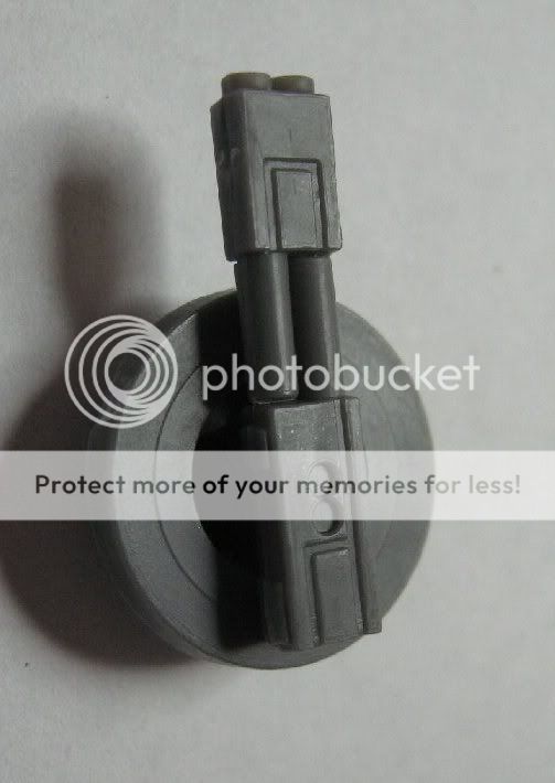

Take 2 of the engine mounts for the Skyrays seeker missiles. Cut the top and bottom rudder sections from the main body. Next cut the engine intake from one side to the beginning of the exhaust housing (see pics for details)
Image Image Image
NOTE Make sure you cut the opposite engine Intake for the 2nd engine mount to the one you just did. This will allow them to line up better for the next step.

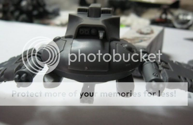

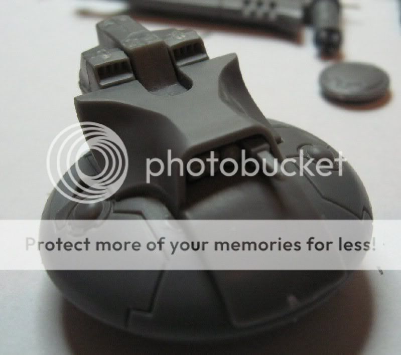

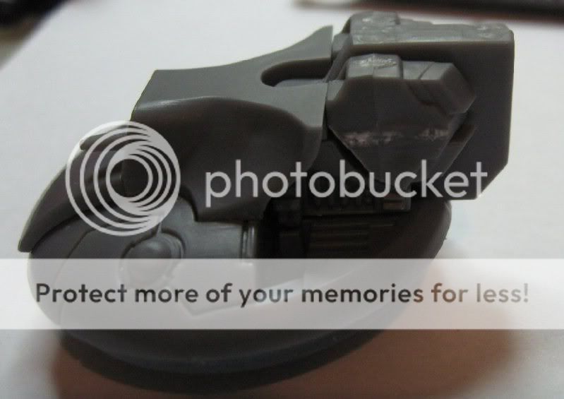

Construct the main Skyray turret as you would if making it normally. However don’t attach the small "Top Hat" shaped bit to the bottom of the Turret as you will need it later on. Also don’t attach the 2 brackets that the wings are normally mounted on. They will not be used for the build.
Once the Turret has been built. Take the 2 engine mounts that you have just cut up and glue them into the turret as shown.
If the intakes don’t sit in the correct position, simply trim them up a little bit until they do.

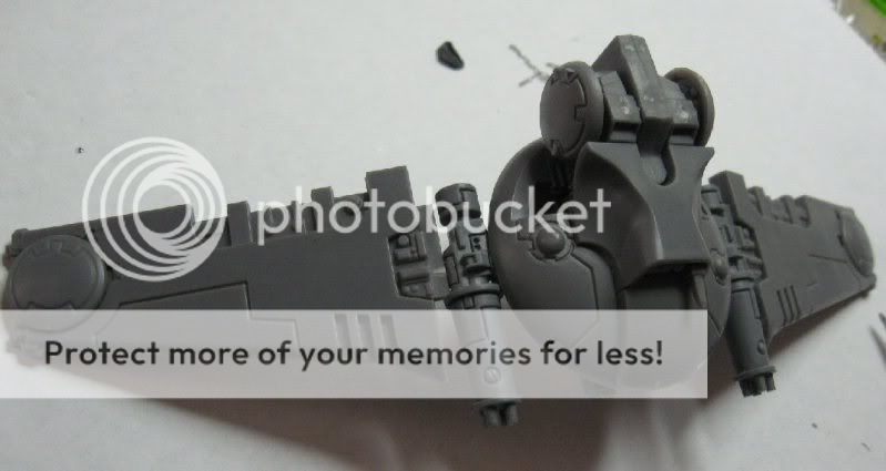

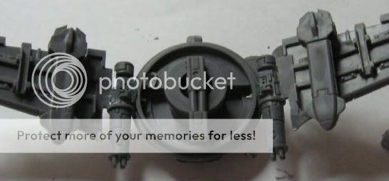

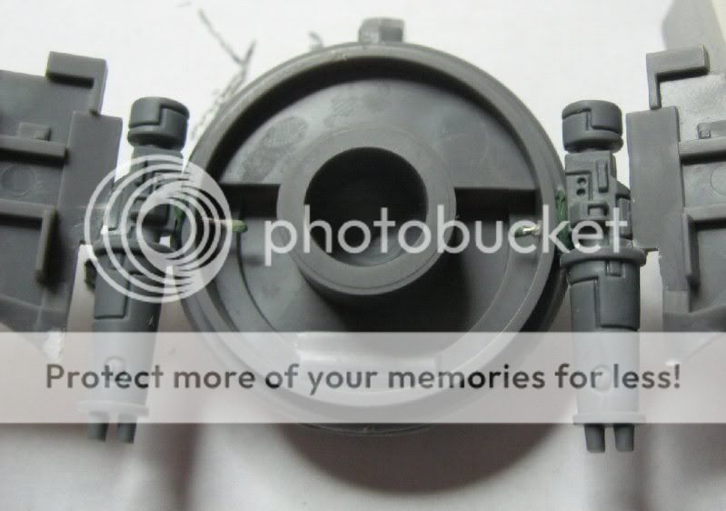

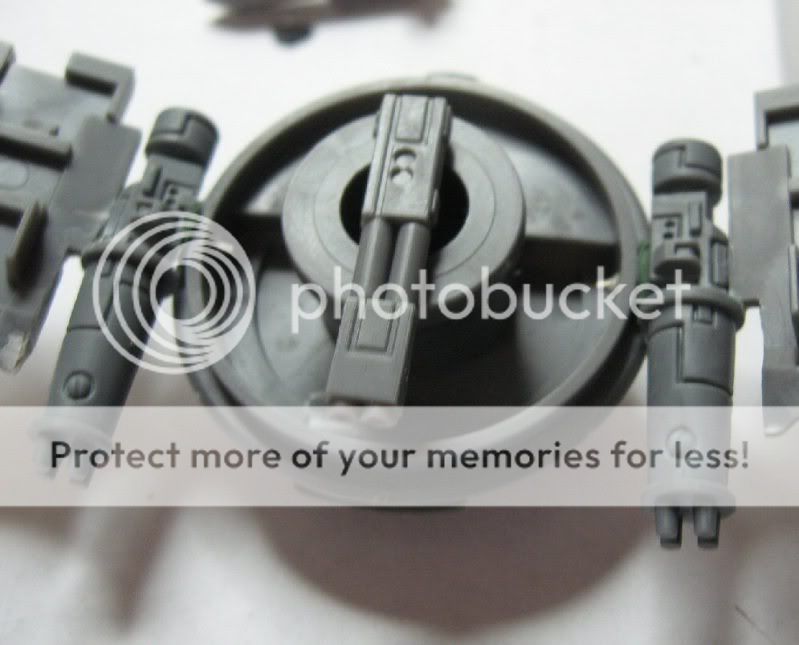

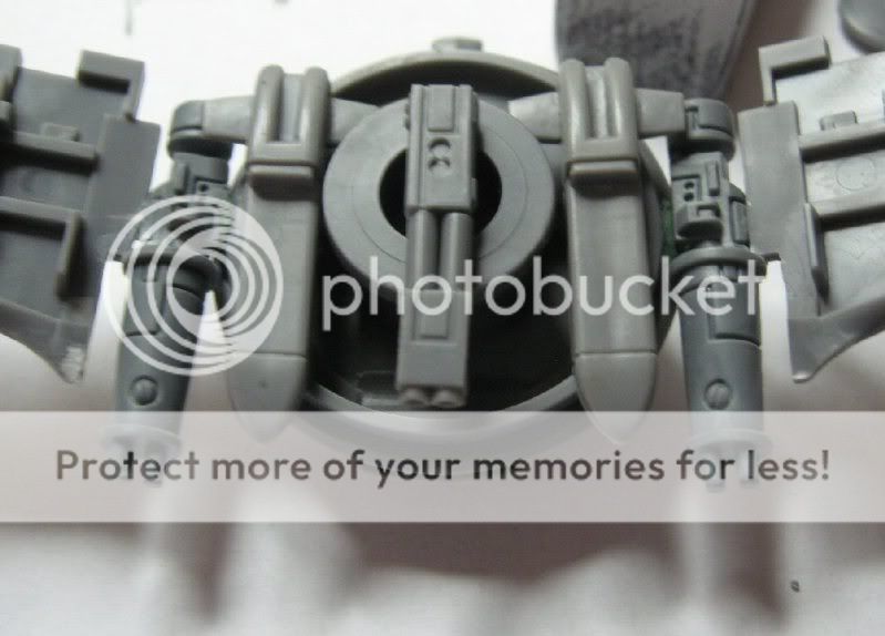

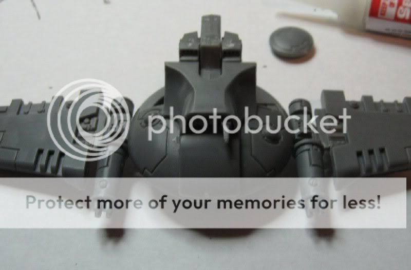

Now I’m sorry to say, This is the tricky bit of the build. Take the turret and drill 2 holes on either side just below the Rim of the body as shown.
This is for the wings to attach to. They need to be on the middle line of the turret and directly across from each other (just use your best judgement)

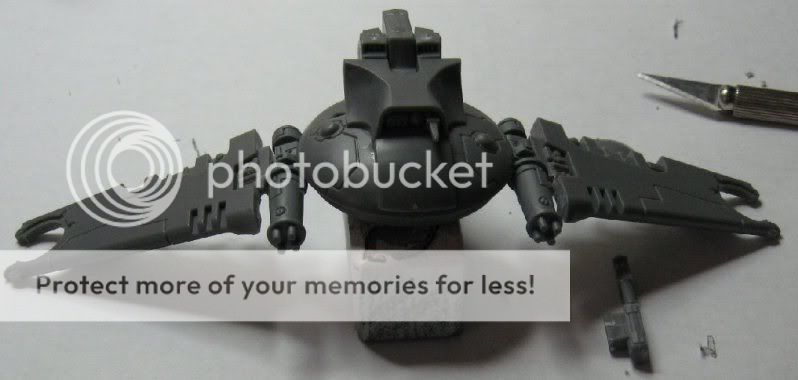

Once you have your holes. Take the 2 wings that you made at the start and thread the wing into the main turret so that it looks like this.
If your holes are a bit off simply fill them with green stuff, let it dry and try again. Once you get it looking like this you can move onto the next step.

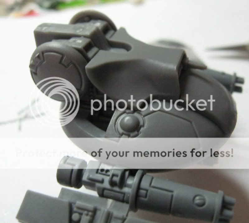

Once you have your wings and holes set in the correct position. Mix up some green stuff. You will need enough so that if you place a blob of it over the hole you will have enough so that it will also touch both the turret and the burst cannon and allow them to stick together.
**Normal plastic melting glue wont work for this next part!! I really recommend "super glue" or "Crazy glue" not sure what its called in other countries**
Put a Bit of glue over the hole in the turret, Place a blob of green stuff over the glue and then place another small amount on the green stuff now sitting over the hole **don't GET YOUR FINGERS STUCK** . Next, Thread the wing through the Glue and green stuff and into the underside of the turret. Do the same on both sides and you should have something that looks like this.
The reason for this is to allow you to get the wings into the "down-ward sweeping" position and will also allow you to tweak the angle to get it just right.
Once you have the wings at a angle that you are happy with, Find a Small block of wood or a model or a base (a couple of dice stacked on top of each other could also do) that will keep the whole thing in the right spot while the green stuff and glue dry.
Its best to leave it overnight just to be sure. If this part fails just break it apart and start again. The green stuff should come off without too much trouble.

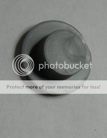

You only need one Marker light for the remora. Construct it as you would when making a Skryray. However you will need to remove the 2 side pegs that would normally allow it to swivel up and down. Take a small bit of sprue and cut it so its the same size as the mounting stand and glue it to the top as shown.

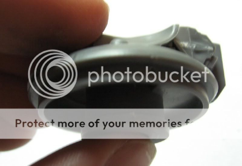

Now take the small "Top Hat" bit of from the base of the turret.
Simply glue the Marker light into the "Hat" like this.
Please make sure you have the marker light in the middle however.
STEP 6
Once the Green stuff and Glue have dried enough that the wings no longer move. Glue the "Top Hat" with the maker light into the hole at the base of the turret as Shown
